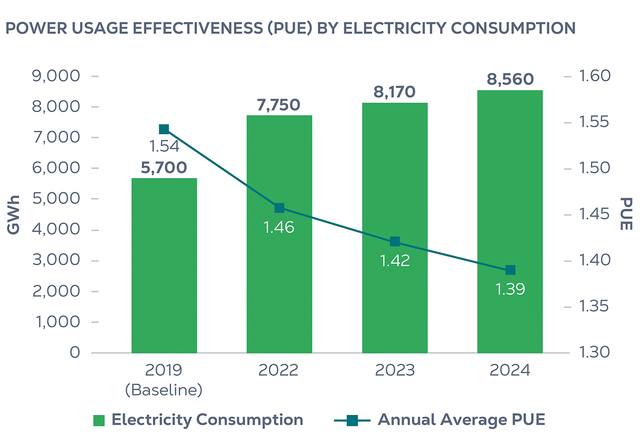

Power usage effectiveness
We monitor PUE to understand usage trends and assess the impact of our energy efficiency interventions. Tracking PUE also allows us to provide data to customers and prospective customers who may prioritize partnering with data center providers operating below specific PUE thresholds. The closer PUE is to 1, the more efficient the data center. We target a global average PUE of 1.33 by 2030. This goal is supported by site-level PUE targets and initiatives that we reassess annually.
Improving PUE presents unique challenges due to the scale of our operations and the diverse locations we serve. Our edge-focused approach prioritizes proximity to our customers, which means adapting to varying climate conditions that can influence efficiency. Despite these challenges, we achieved a global annualized average PUE of 1.39 in 2024, a 6% improvement from 2023 despite an expanded portfolio. Technology alone did not get us here. Our culture of continuous improvement, enacted every day by our site-level teams and supported by a top-down dedication to making our operations more sustainable, contributed to this accomplishment.
Equinix played a key role in the ISO/IEC 30134-2 power usage effectiveness review in 2024. Through our active participation in the ISO/IEC 30134 committee, we contribute our expertise and experience with PUE to help update and improve existing best practice guidance. This underscores our dedication to optimizing energy efficiency and reducing our environmental impact.

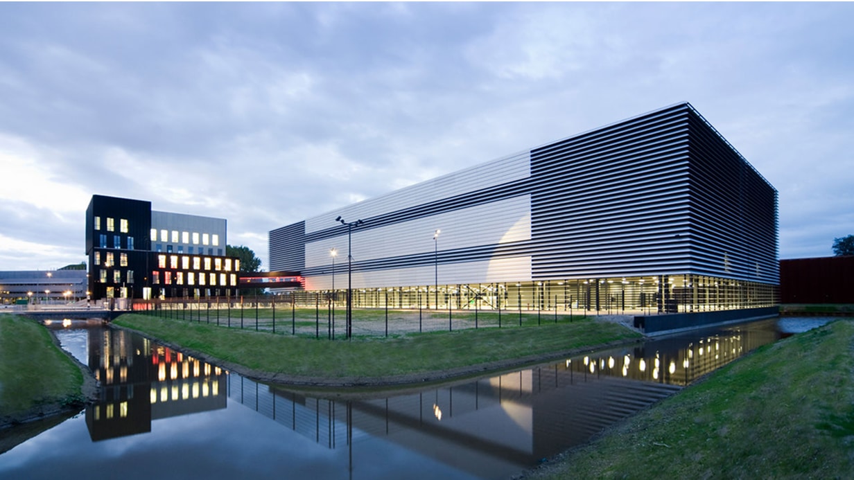

Case Study
DB3
Our DB3 team achieved an 8% PUE reduction in just six months through airflow management (Phase 2). Their approach tailored cooling to each data center hall and was successful due to:
  • Collaboration and communication between the cross-functional site teams and with customers.
  • Streamlined workflows that clearly delineated responsibility.
  • Access to Equinix Smart View power usage reports that provided key insights.
Execution of this project led to nearly 100,000 kWh of savings in less than a year.

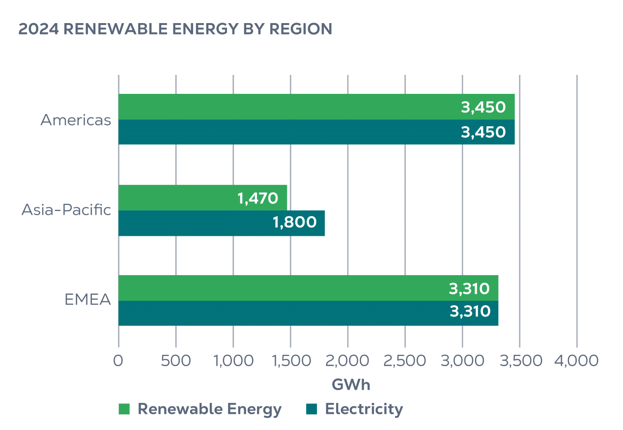

Clean and renewable energy
In 2024, we achieved 96% global renewable energy coverage across our global portfolio, which includes 268 data centers in 35 countries. A variety of energy attribute certificate (EAC) types and procurement methods enabled this achievement—including power purchase agreements (PPAs), bundled and unbundled contracts and grid-delivered renewables. Across the board, we aim to:
  • Utilize renewable and low-carbon energy.
  • Procure local sources of renewable energy where possible.
  • Seek new or recently built generation sources.
  • Advocate for favorable renewable energy policies and consider renewable energy availability when locating new data centers.
Our goal is to achieve 100% clean and renewable energy coverage across our global portfolio by 2030. We demonstrate our dedication to reducing our impact and helping customers achieve their climate priorities by pursuing clean and renewable energy coverage for both building overhead and customer IT equipment. As we near our target, we continue to enhance the quality of our renewables, investing in projects that contribute new generation capacity to the grids where we operate.

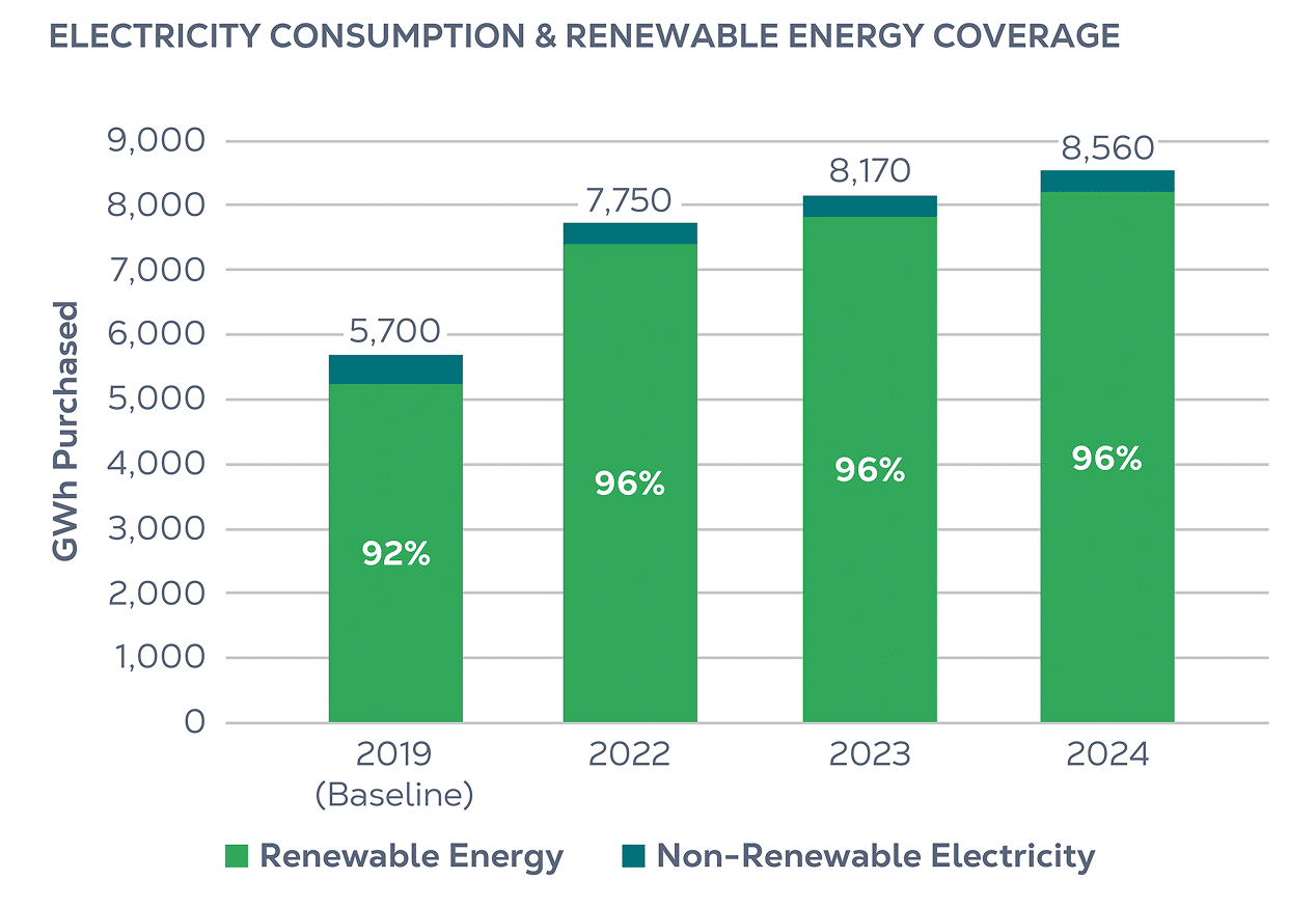

Consumption and renewable energy
8,560
GWh of electricity consumed
793,000
equivalent to electricity usage of 793,000
U.S. homes in a year2
96%
renewable globally
250
sites with 100% RE Coverage
1,285
MW of PPAs under long-term contract
219
MW of PPAs signed in 2024
1included in the 2024 operational (Scope 1 & 2) GHG boundary
2Based on the U.S., EIA’s 2022 average household electricity consumption

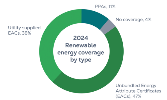

Our renewable energy portfolio includes procuring EACs from several sourcing mechanisms. Key terminology for understanding the RE landscape is detailed below, as well as in an Equinix blog.
Energy attribute certificates (EACs)
are market-based instruments that represent the environmental benefits associated with the production of one megawatt-hour (1 MWh) of electricity generated from renewable energy sources. The sources typically include, but are not limited to, wind, solar, hydropower and geothermal generation. EACs serve as a legal claim to the renewable energy generated, allowing organizations to substantiate their commitment to sustainability and renewable energy.
EACs can be generated from PPAs (see below) or purchased through third-parties, utilities or retail energy providers. Purchases from third parties are typically referred to as unbundled contracts since the EAC is unbundled from the underlying electricity contract, whereas bundled contracts include both the cost of the EAC and underlying electricity. Bundled contracts are typically only available through utilities or retail energy providers.
In many cases, we utilize unbundled or bundled EACs as an initial step in our renewable energy sourcing journey, and we are actively working to transition away from them as we pursue more integrated solutions such as PPAs.
Power purchase agreements (PPAs)
are long-term contracts between a buyer and a seller for the purchase of electricity at predetermined prices. At Equinix, we have a strategic focus on rapidly scaling our renewable energy PPA efforts in the markets where we operate. We believe that these agreements provide essential financial support to renewable energy projects, enabling them to secure the necessary funding to develop new assets. By entering into PPAs, Equinix not only enhances its own sustainability efforts but also contributes to the growth of renewable energy generation in the grids where we operate.
Utility-supplied EACs
includes EACs that are bundled into a supply contract and represent an arrangement where a retail energy supplier provides electricity to consumers along with the associated environmental benefits of that energy. In this context, EACs serve as proof that a specific amount of electricity has been generated from renewable sources, such as wind, solar, hydropower or geothermal energy.
2024 Renewable energy coverage by type

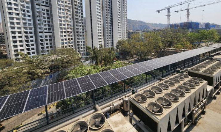

On-site installation
Due to the scale of our operations, generating sufficient solar electricity on-site to meaningfully reduce our footprint is not practical. As a result, on-site installations contribute only marginally to our renewable energy strategy. These projects still play a valuable role in decarbonizing our operations and/or local grids by adding new generation capacity, so, where possible, we install solar arrays at select sites during construction. Currently, we have 6 MW of installed on-site solar capacity across our global portfolio.
A solar panel installation at our MB2 site in Mumbai, India.
